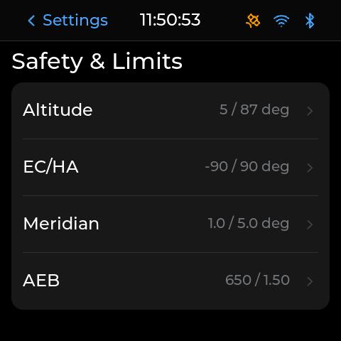

6.1 Safety-function overview​
Open Settings > Safety & Limits on AHC. Read and record existing values before changing them. The reference interface contains Altitude, EC/HA, Meridian and AEB controls.
AHC safety and limits overview
FunctionPurposeImportant dependency
Altitude limitsRestrict calculated pointing below/above configured altitude boundaries.Correct time, location and pointing coordinates.
Meridian limitsGovern allowable GEM travel and flip behavior around the meridian.Correct mode, pointing state and software coordination.
EC HA LimitPreventive control: constrain encoder-based RA travel, including when sky coordinates are incorrect.Valid encoder data, correct reference, enabled limits and suitable physical boundaries.
AEBPassive/reactive protection: respond after abnormal motor loading is detected and help mitigate its consequences.Enabled state, valid baseline/threshold and firmware-supported behavior; payload, inertia and slew speed affect the outcome.
Physical RA brakeProvides rated holding torque during the relevant power/brake state.Load torque within its holding capability.

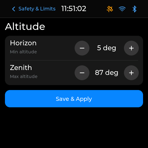

6.2 Motion and altitude limits​
Horizon is the lowest allowed calculated target altitude. Overhead, shown as Zenith in the AHC altitude page, is the upper altitude limit. These concern sky pointing, not a measurement of physical tripod clearance.
  1. Verify observing location, time and pointing state.
  2. Open Settings > Safety & Limits > Altitude.
  3. Read the current Horizon and Zenith settings. Choose values suitable for the site, observing plan and mount behavior.
  4. Save/apply using the displayed control, then restart the mount to activate the new limits.
  5. Reconnect AHC, reopen the page and read the settings back.
  6. Confirm that ordinary targets inside the intended region remain available without testing a dangerous motion.
AHC altitude-limit settings

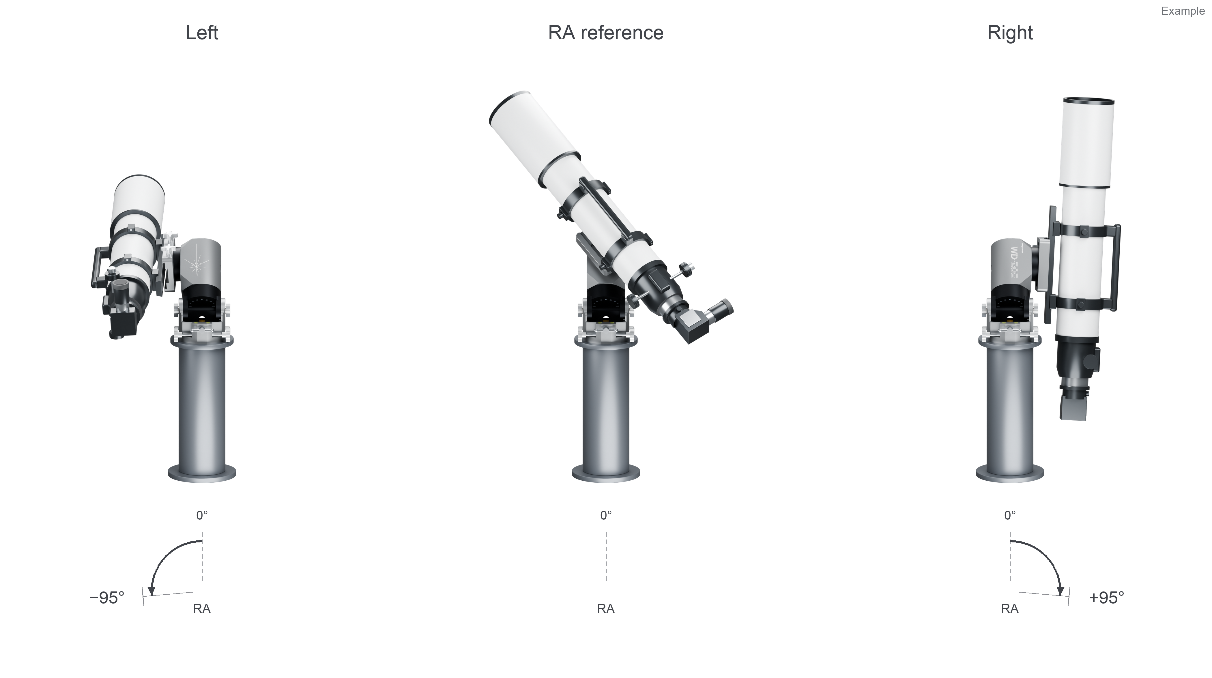

Read the boundary illustrations​
The center position below is the RA encoder Home reference (0°). The left and right examples show mechanical RA rotation from that reference toward two separate boundaries. The −95° and +95° shown are illustrative positions based on the current reference firmware's initial EC HA settings, not a guaranteed safe range for every telescope, DEC orientation, camera or cable route. A previously configured mount may retain other settings. The picture's Left and Right are viewing directions from behind the mount looking north; do not equate them automatically with the East and West field names on a particular controller.
The angles refer only to mechanical RA rotation from its Home reference. The center image does not imply that the DEC axis is also at Home.
Three WD-20EP RA-axis positions: example left boundary at minus 95 degrees, RA Home reference at zero, and right boundary at plus 95 degrees
Set both limits only after checking the complete loaded assembly at the relevant DEC orientations. Keep each boundary inside verified clearance, allowing for movement during deceleration. If the RA Home reference changes, the same numerical boundaries describe different physical positions and must be checked again.

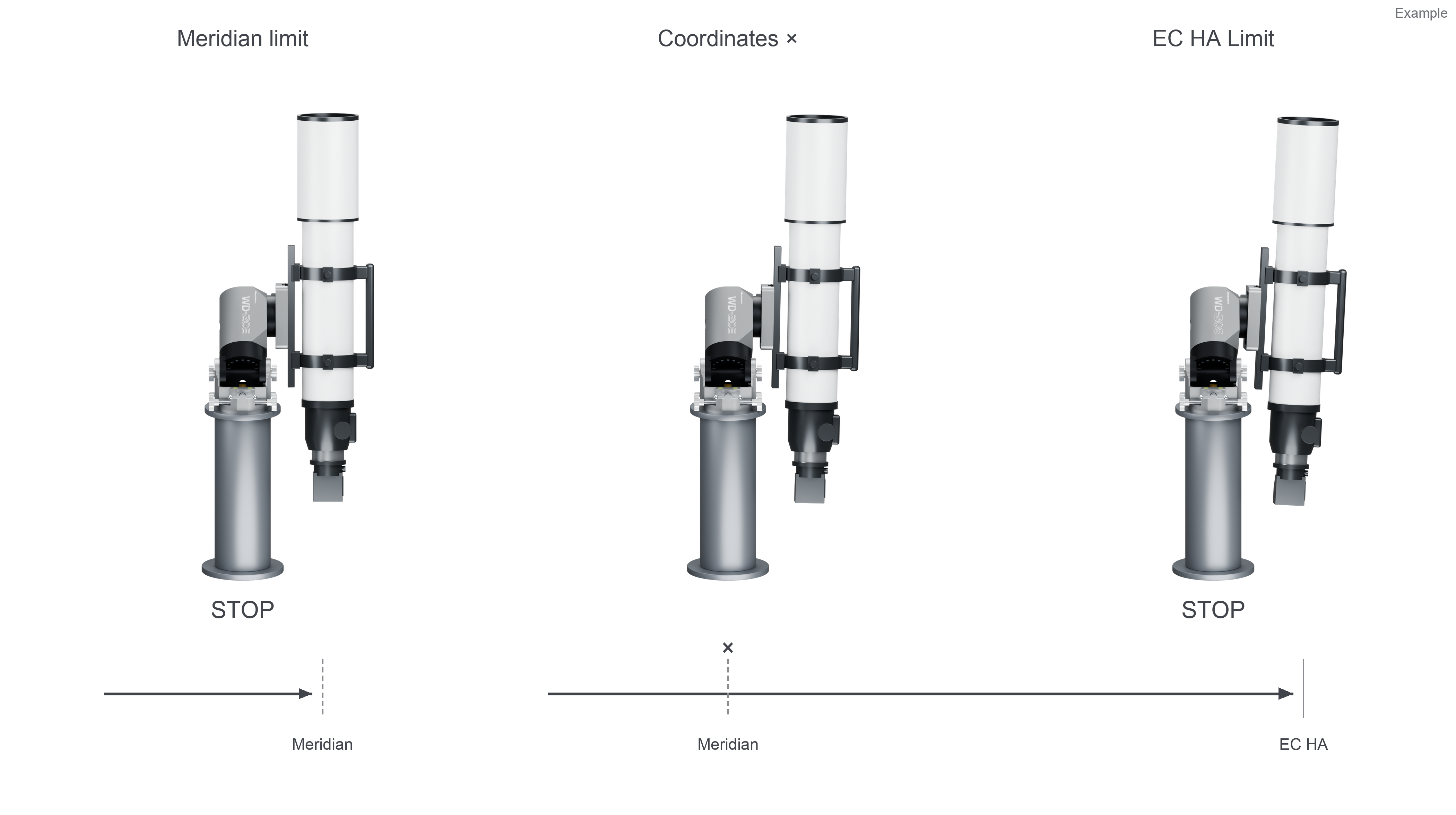

Watch the coordinate-error animation​
The following 12-second conceptual animation compares a wrong pointing-coordinate solution with EC HA Limit off and on. Use the playback controls to pause at the key stages; the solid mount is the actual mechanical position and the translucent mount is the incorrect coordinate alias shown for comparison.
A conceptual comparison of coordinate-based Meridian protection and encoder-referenced EC HA travel protection. The angles and geometry are examples, not a clearance test.
  1. Wrong coordinates, EC HA off: the displayed coordinate alias does not match the actual RA position. The expected Meridian stop can therefore occur at the wrong physical place, allowing the real telescope to move farther than intended. The contact shown is a simulated consequence.
  2. Wrong coordinates, EC HA on: the same coordinate error remains, but the encoder checks actual RA rotation relative to the valid Home reference.
  3. At the EC HA boundary: the reference example commands a stop at −95° mechanical RA, before the illustrated contact position. The actual stopping point may be farther along because of speed, load and deceleration; EC HA does not check DEC, accessories or cables.
The arrows show a sequence, not a time or angle scale. A wrong Sync can shift the software's apparent position; an enabled EC HA boundary uses the separate mechanical RA reference.
Three-stage comparison: a correct coordinate-based Meridian stop, a missed stop after coordinate error, and an EC HA encoder-boundary stop
CAUTION · Illustration only
The contact in the animation is simulated. Never deliberately drive the telescope into a pier or tripod to test a limit. Enabling EC HA does not correct wrong coordinates, repair a bad Home reference or guarantee that a large or high-speed load will stop before contact.
Configure the boundaries​
The reference firmware initializes EC HA Limit enabled with −95° / +95° mechanical RA boundaries, but a configured mount can retain other values. The current AHC page may show locally stored fields rather than reading the mount's active boundaries. Treat the illustrations and any untouched AHC fields as examples until the actual configuration is confirmed; saving from AHC writes both boundary fields.
  1. Confirm the installed WD-20EP firmware, GEM mode and valid Home/reference state.
  2. Inspect the telescope, camera, focuser, counterweight and cable clearance on both sides of the travel.
  3. Open Settings > Safety & Limits > EC/HA. Confirm the enabled state and actual stored boundaries using a supported readback or WarpAstron support if the AHC display cannot establish them.
  4. Record the previous values. Change only values whose units and reference directions you understand; do not save simply to match the illustration.
  5. Keep each boundary inside a known clear region, leaving a margin for deceleration and cable movement.
  6. Coordinate the boundaries with meridian limits, so the intended normal flip is not unexpectedly blocked.
  7. Save/apply the settings, restart the mount and reconnect AHC. Confirm the mount's stored values and enabled state through a supported method before relying on the boundary.
  8. Verify normal movement within the known safe region at low speed, while supervising the equipment. Do not create a collision to test protection.

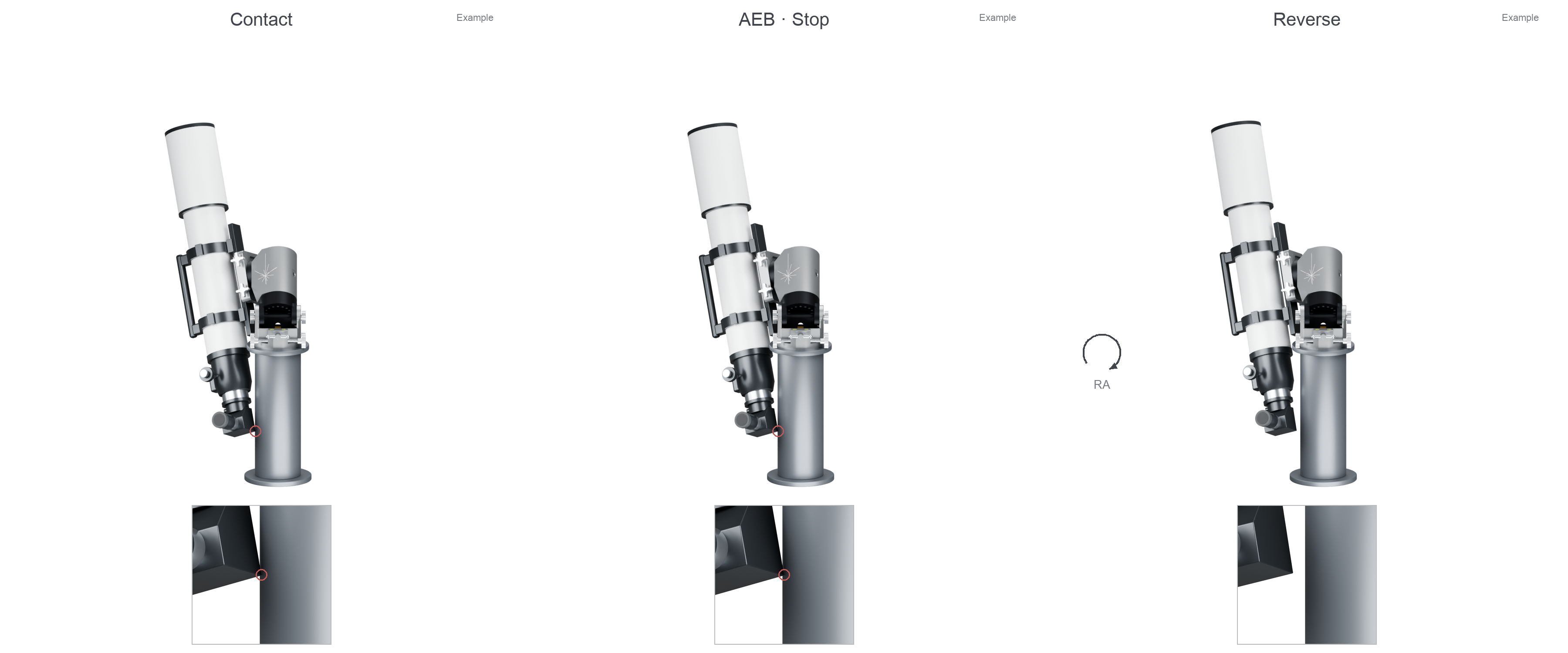

Illustrated AEB response​
The illustration shows a conceptual abnormal-load event, assuming AEB has been enabled and tuned for the installed load. Read it from left to right: an obstruction can make contact before AEB detects the increased motor load; the mount then commands a stop and, on the supported implementation, may briefly reverse to relieve pressure. Confirm that motion has ended before inspecting or touching the equipment.
Contact → AEB stop → possible brief reversal. The close-ups show only the modeled contact point; relief at that point does not verify clearance elsewhere or rule out damage.
Three-stage WD-20EP AEB example showing telescope contact with a pier, an AEB stop, and brief reverse movement that relieves the modeled contact
The 12-second animation shows the same sequence. Pause it to compare the contact point before and after the illustrative reverse movement.
A conceptual AEB response, not a real collision test. The timing, amount of reversal and clearance shown are animation choices, not firmware specifications.
CAUTION · Do not use contact to test AEB
Never deliberately drive the telescope into a pier, tripod or other object. This example isolates the AEB response; it does not simulate simultaneous EC HA or coordinate-based limits. Its contact position is beyond the separate ±95° EC HA illustration above. With a valid, enabled EC HA boundary placed before that position, the preventive RA limit should constrain travel first. AEB remains a limited fallback if abnormal loading occurs; it does not guarantee that a heavy or fast-moving setup will stop without damage.

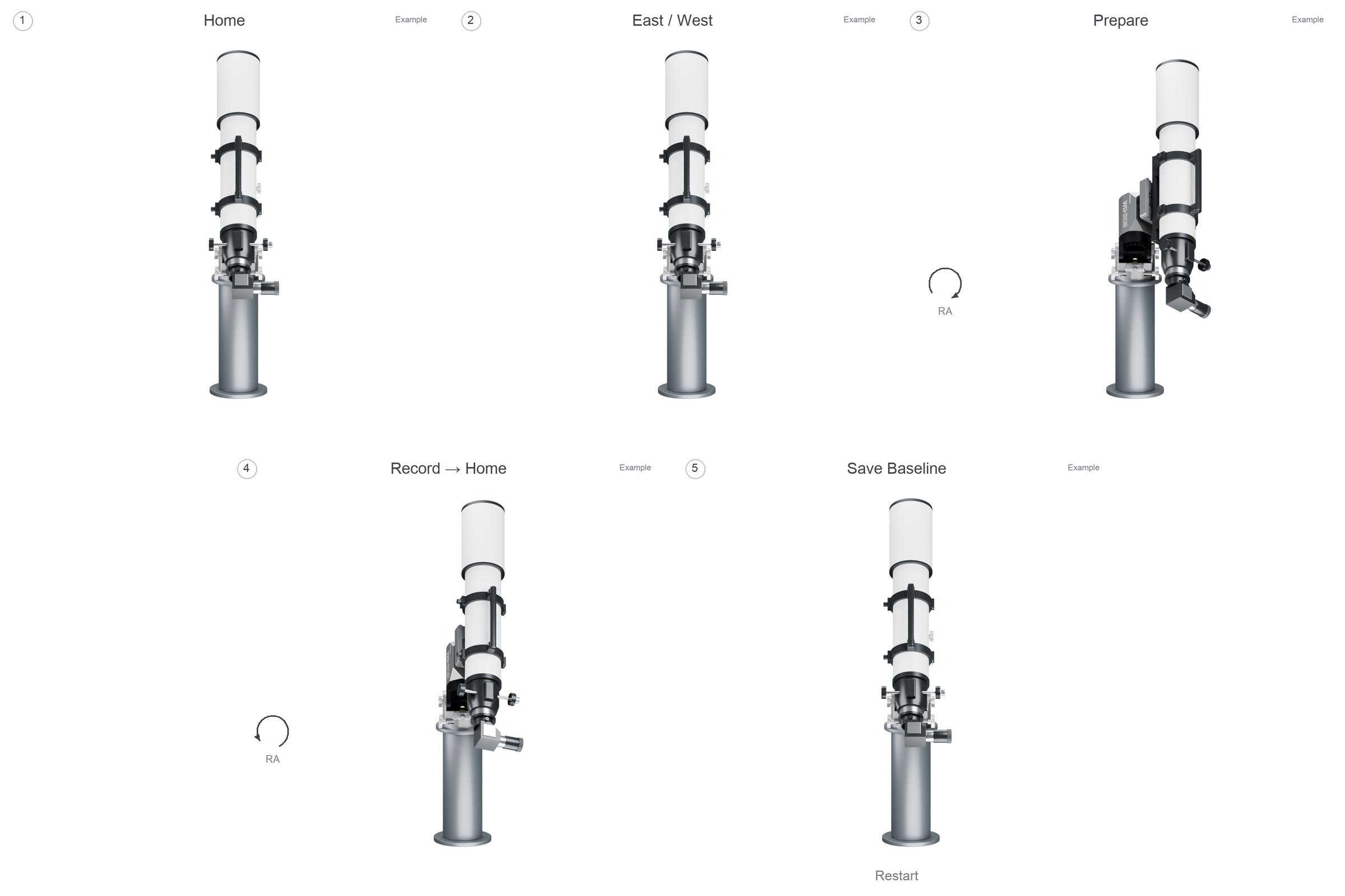

AEB Auto Tune​
AHC firmware 1.1.0 or later is required for AEB Auto Tune from AHC. The WD-20EP mount firmware must also support the guided workflow; meeting the AHC minimum alone is not sufficient. The presence of an AEB setting on older firmware does not establish support for guided Auto Tune. Use the workflow offered by the installed, supported combination; do not substitute a legacy PC-tool sequence for it.
WARNING · Reduced protection during recording
Auto Tune records motor loading while normal current-based AEB protective action is reduced/suppressed. Check the entire chosen travel in advance, remain beside the mount, and be ready to press STOP. Disconnect independent PC, ST4 and other command sources before starting. Do not use a deliberate collision as a calibration test.
Auto Tune sequence: Home → select East or West → prepare → record while returning Home → save the baseline and restart. The illustrated preparation angle is not a firmware setting or a required physical position.
Five-stage conceptual WD-20EP AEB Auto Tune sequence: Home, choose East or West, move to a preparation position, record while returning Home, then save the baseline and restart
The drawing shows RA movement for a shared baseline, with DEC kept at Home. It helps identify the stages to supervise; use the actual AHC prompts for the selected direction, any Restore Speed recovery, saving and restart. The drawing is not an instruction to move the axes manually into its pictured angles.
Prerequisites
  • AHC firmware 1.1.0 or later, compatible WD-20EP mount firmware and a connected AHC.
  • GEM mode, valid encoder position and enabled EC/HA and AEB functions as required by the workflow. If any of those safety settings were changed, restart the mount and verify their active states before Auto Tune.
  • A physically correct, completed Home state, tracking off, no active slew or guiding, and the required unparked state.
  • Clear travel toward the selected east/west preparation position and back to Home, including all attached equipment and cables.
  • No independent controller issuing commands; stable power and access to STOP.
Procedure
  1. Complete the prerequisite checks, then open Settings > Safety & Limits > AEB > Auto Tune.
  2. Select East or West according to the side whose full route is clear. Read and acknowledge the displayed conditions.
  3. Press Start Auto Tune. Watch the preparation movement and stopped-state checks.
  4. Continue supervising while the mount records loading and returns to Home. Do not manually change speed, mode, protection settings or position during the workflow.
  5. If motion is unexpected or clearance becomes doubtful, press STOP / Stop / Cancel and follow the recovery screen.
  6. When the result is presented, confirm the mount has returned to Home and stopped. Review the outcome; a lack of actual calibration movement is not a valid successful result.
  7. Choose Save Baseline to accept the result, or Discard to retain the previous baseline. Wait for the displayed save/cleanup result.
  8. If the workflow requests Restore Speed, complete it and verify recovery before leaving the workflow.
  9. If you saved a new baseline, restart the mount to load it. Reconnect, check AEB/EC HA status and observing data, and verify the normal operating speed before resuming.
The reference workflow derives a shared baseline from RA movement; it does not perform an independent DEC calibration. The supported guided implementation manages preparation speed and recording. Do not attempt to reproduce its motion with a stopwatch or raw commands from a terminal.

After an AEB event​
Stop the sequence and wait until motion and any protective reversal have ended. Inspect for contact, cable snagging, overload, stiff movement, loose attachments or a changed equipment configuration. Read event information and the current baseline/trigger settings.
Remove the cause before resuming. If activation repeats without an obvious obstruction, check supply stability and calibration with support; do not repeatedly raise the threshold to suppress an unexplained event.
