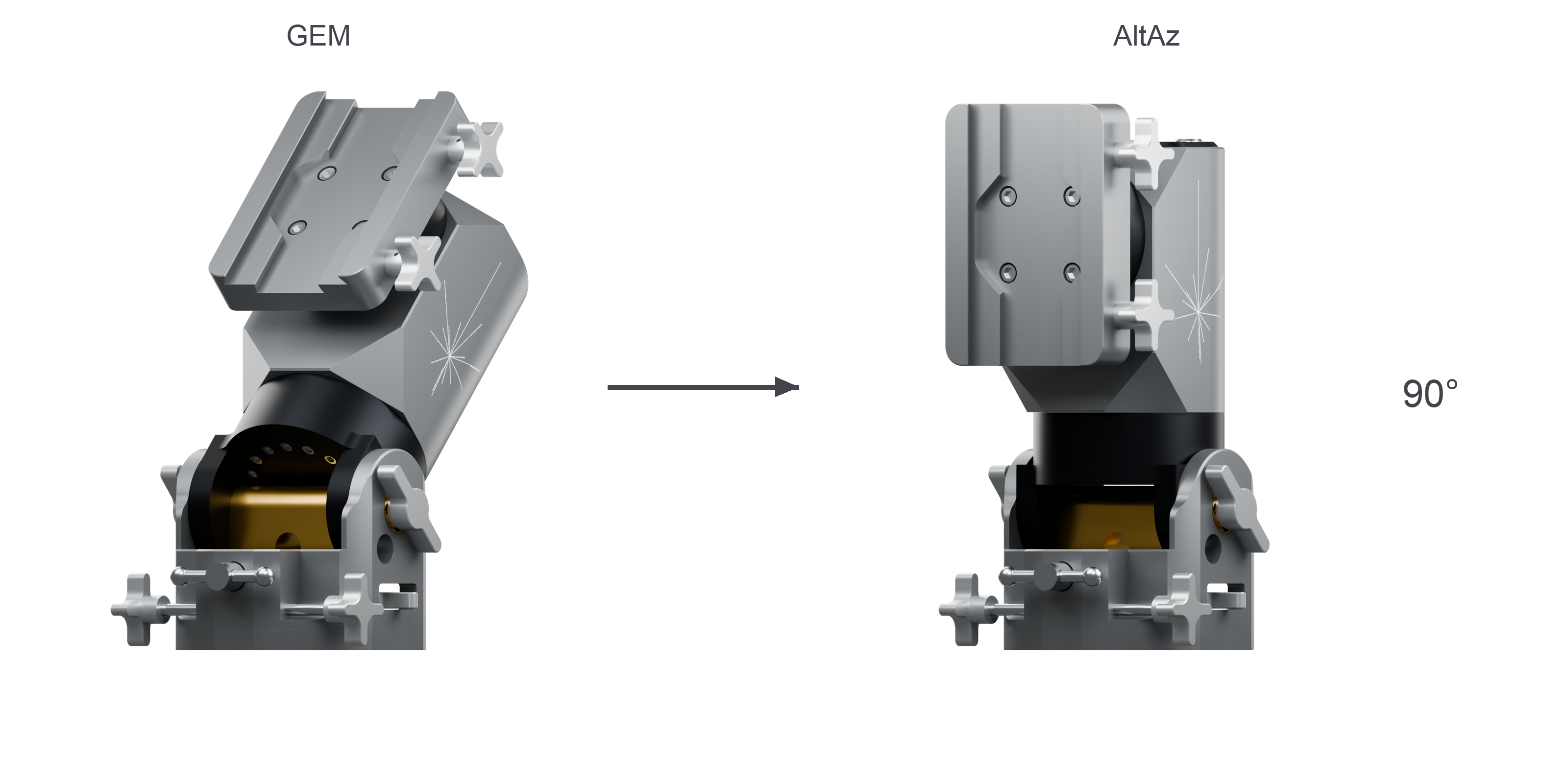

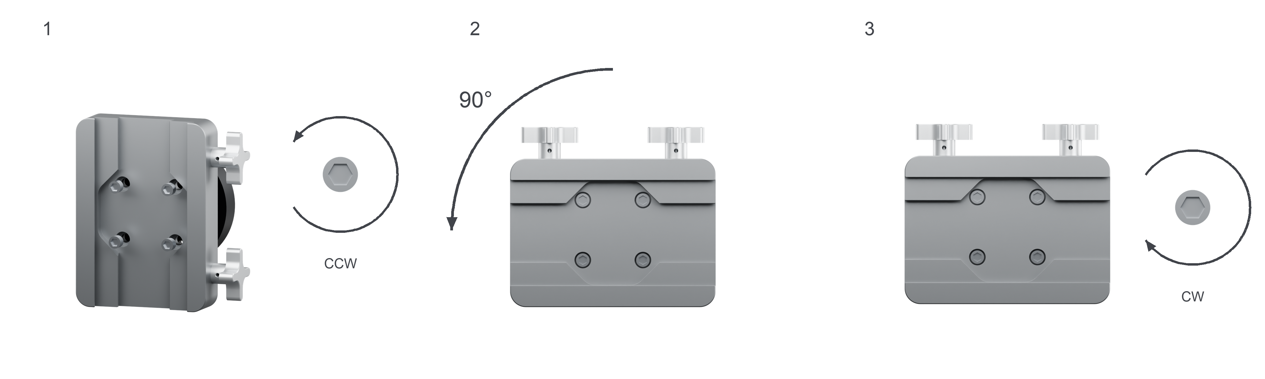

Changing operating mode​
Mode switching changes both the physical arrangement and the controller's operating mode. Follow 5.10 Switch between GEM and AltAz, including unloading, the recommended 90° saddle reorientation, AHC mode selection and the mount restart. A software selection alone does not complete the mechanical conversion.

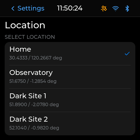

Observing site​
Set the site on AHC​
  1. Open Settings > Location.
  2. Select Home, Observatory, Dark Site 1 or Dark Site 2.
  3. Enter latitude, longitude and elevation, or select Use GPS Location after a valid fix. Use Mount Location copies the values already stored in the mount.
  4. Press Save & Apply and verify the resulting location.
AHC observing-location page

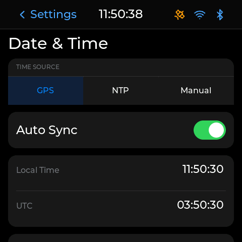

Time source​
In Settings > Date & Time, choose:
  • GPS: wait for valid GPS data and use the controller's synchronization controls.
  • NTP: use an internet-connected STA network; the controller synchronizes from network time.
  • Manual: enter date, time and time zone, then apply them.
You can also set the mount time through the OnStep ASCOM setup panel or another ASCOM application that supports time updates. In the reference OnStep panel, Date/Time and Auto. set Date/Time on Connect control this behavior. Verify the computer's clock, date and time-zone settings before enabling automatic updates. Follow the installed driver's Standard Time / daylight-saving convention, and check the resulting UTC on the mount rather than assuming every interface handles seasonal time changes identically.
CAUTION · OnStep ASCOM time-zone sign
The OnStep ASCOM UTC Offset field uses the opposite sign to a civil time-zone value: it is the number of hours added to local time to obtain UTC. For a site at UTC+8, enter −8 (or −08:00, according to the field format); for UTC−5, enter +5.
This sign reversal applies to that OnStep ASCOM field. AHC's civil time-zone selector and the computer's time-zone setting use their own conventions; a UTC+8 site normally remains +8 there. Do not copy the ASCOM value blindly into AHC or an INDI field. Verify both local time and UTC after applying the settings.
Confirm the time zone for the actual observing site before synchronizing, including when using GPS or NTP. If Auto Timezone is enabled, verify its result rather than assuming the chosen offset is correct. Check both UTC and Local Time. For example, at UTC+8 a local time of 22:00 corresponds to UTC 14:00 on the same date. Keep date rollover in mind near midnight. A time-zone change must not be mistaken for an eight-hour change in UTC.
AHC date and time page
GPS synchronization​
GPS supplies time and location data, but a valid fix does not by itself confirm the configured time zone. Open Settings > Date & Time, confirm the site's correct time-zone offset, and verify UTC and Local Time after synchronization. Check the result of Auto Timezone if enabled, including any applicable seasonal offset. Do not proceed to GoTo or Park with a wrong zone.
AHC uses direct satellite GPS, not A-GPS (assisted GPS). It must receive satellite signals itself. Give the controller a usable view of the sky and keep it clear of metal objects or enclosures that can block reception. Buildings, roofs and other obstructions can delay or prevent a fix; a Wi-Fi connection does not replace satellite reception.
The first fix after a cold start generally takes longer and may require 3–5 minutes, or longer with poor reception. Allow time for acquisition in a suitable position. Searching is not a valid fix; verify Fixed and plausible coordinates before using GPS data. With NTP, wait for NTP & mount synchronized. Time ready - waiting mount means the controller has time but has not finished updating the mount.
AHC GPS status and synchronization controls
AP Wi-Fi alone has no upstream internet connection for NTP. Use GPS or manual time when operating directly on the AHC AP without an internet-connected STA route.

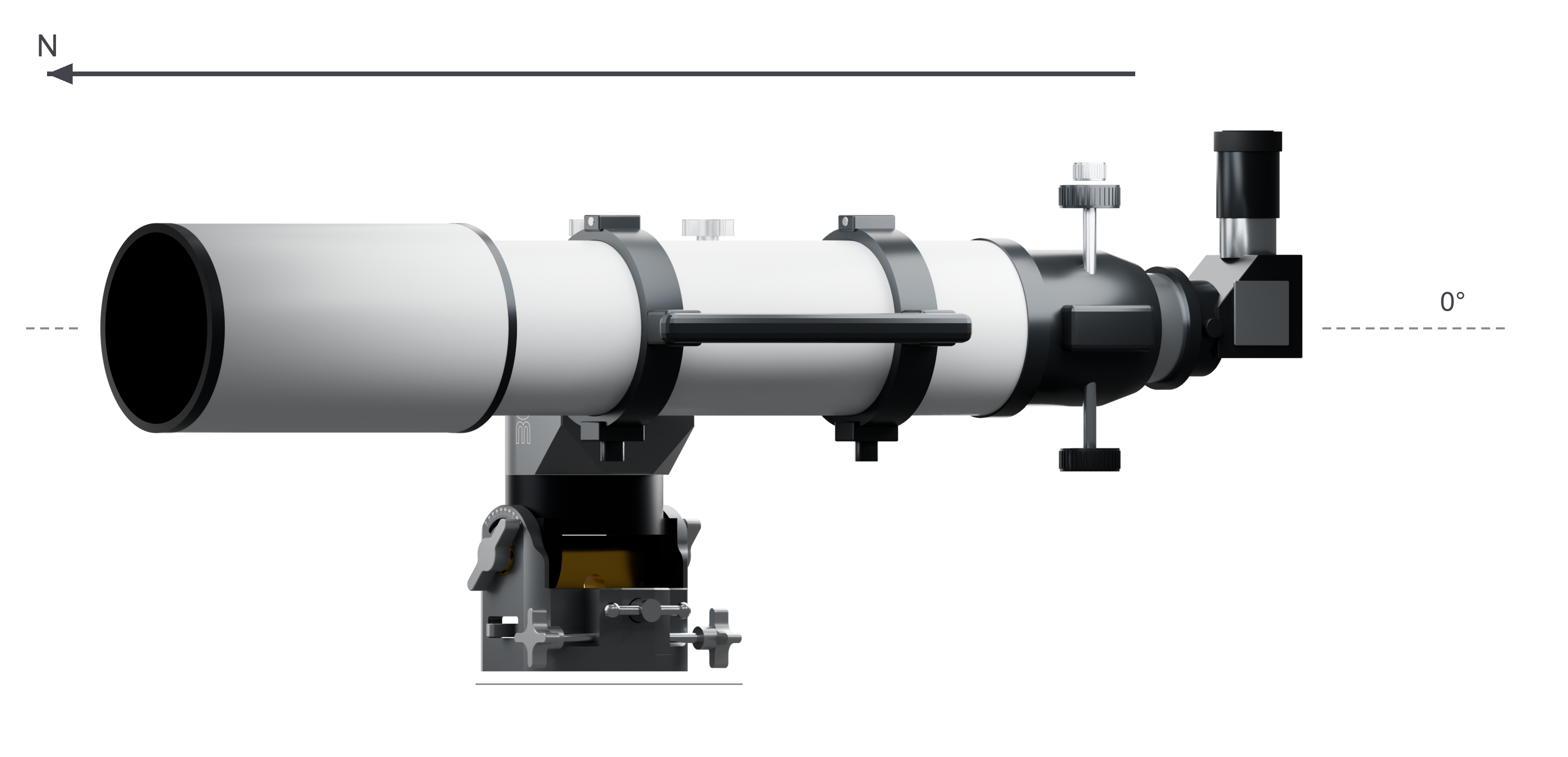

In GEM mode, the default Home points the telescope toward the north celestial pole (NCP) in the northern hemisphere or the south celestial pole (SCP) in the southern hemisphere. The mount determines the hemisphere from the configured observing-site latitude, so verify the location before establishing the reference.
In the recommended AltAz arrangement, the default zero position points the telescope toward the north horizon: azimuth 0°, altitude 0°. The mount's mechanical latitude configuration is 90°. See AltAz zero position for the saddle orientation and conversion checks.

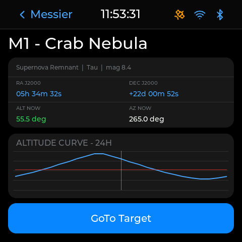

  1. Open GoTo on AHC and choose Solar System, Messier, NGC, IC Catalog or Named Stars.
  2. Browse the list or search by name, number, type or constellation. Check the displayed current altitude.
  3. Open the target details and review its altitude curve and current coordinates.
  4. Confirm time/location are valid and the complete movement path is clear.
  5. Confirm Tracking is enabled before the first GoTo after power-on.
  6. Press GoTo Target and watch the physical motion until it finishes.
  7. Verify the result through an eyepiece, camera or a plausible plate solve. If using the solve to synchronize pointing, verify the field and actually send Sync as described below.
AHC target details with altitude plot and GoTo control
Below Horizon means the target is below the configured horizon and GoTo is unavailable. Waiting Mount Time means the required time data are not ready. Resolve the cause rather than bypassing the check.
If there is no clear GoTo movement, first check whether Tracking has been enabled since power-on and whether the mount is receiving commands. Also check Park state, warnings and the reported target/motion state; a target close to the current pointing may require little movement. Correct the cause and confirm the route before retrying. Do not repeatedly send GoTo or disable limits to force movement; see 8.5 Movement and GoTo problems.

5.10 Switch between GEM and AltAz​
GEM (German equatorial) and AltAz (altazimuth) use different axis arrangements and tracking coordinates. Complete the mechanical conversion, select the matching mode in AHC and restart the mount before commanding normal movement. Changing the software mode does not physically turn the latitude mechanism or reorient the saddle.
SetupGEMAltAz
Mechanical latitude configurationApproximately the absolute observing latitude, with the RA axis aimed at the appropriate celestial pole90°, with a level support so the azimuth axis is vertical
Recommended saddle orientationNormal equatorial orientationReindex the unloaded saddle 90° so the telescope is horizontal at the default zero position
Initial referenceVerified GEM Home, then polar alignment and pointing checksDefault zero: telescope toward the north horizon, azimuth 0°, altitude 0°
AHC mode after restartGEMAltAz
WARNING · Unload before mechanical conversion
Stop tracking, guiding, GoTo, homing and parking. Disconnect applications that can command movement. Remove the telescope and attached loads before changing the coarse latitude range or removing saddle mounting screws. Keep the mount secured to a stable support, support the body or saddle while its fasteners are released, and switch off mount power for the mechanical work. Never loosen these fasteners with the telescope installed.

Set the mount's mechanical latitude configuration to 90° on a level support. This angle describes the mount mechanism; it is not the telescope's sky altitude at the AltAz zero position.
GEM configuration changing to the upright 90-degree mechanical latitude configuration used for AltAz
Reindex the dovetail saddle by 90°​
The illustrated conversion uses the four M6 saddle mounting screws, not the two dovetail clamp knobs that retain the telescope.
  1. Support the unloaded saddle and remove the four M6 saddle mounting screws with a correctly fitting manual hex key. Counterclockwise loosens a screw when viewed from its head.
  2. Rotate the saddle 90° to the illustrated AltAz orientation and align the mounting holes. Reorient the saddle at its mounting interface; do not use a DEC motor command or change encoder Home calibration to imitate this conversion.
  3. Refit the original compatible M6 screws, start them by hand and secure all four evenly. Clockwise tightens a screw when viewed from its head. Verify the saddle cannot lift or rock before installing the telescope.
1 — Support the unloaded saddle and remove its four M6 mounting screws. 2 — Reindex by 90° and align the holes. 3 — Refit and secure all four M6 screws. The dovetail clamp knobs are separate from these mounting screws.
Three saddle-reindexing steps: remove four M6 mounting screws, turn the unloaded saddle 90 degrees, then refit and secure the screws

AltAz zero position and first checks​
With a level support and the recommended 90° saddle orientation, the default AltAz zero position has the telescope pointing horizontally toward the north horizon: azimuth 0° and altitude 0°. Aim toward true north rather than assuming an uncorrected compass reading is exact.
The two angles describe different things: 90° is the mount's mechanical latitude configuration; 0° altitude is the telescope's elevation above the horizon at the default zero position. Reindexing the saddle makes its mounting orientation agree with this expected reference.
Default AltAz zero: telescope toward north (azimuth 0°), horizontal at the horizon (altitude 0°). The illustrated telescope and accessories show orientation; check clearance with your own equipment.
AltAz default zero with a level mount and telescope pointing north at zero degrees above the horizon
